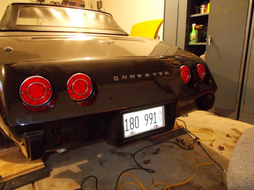

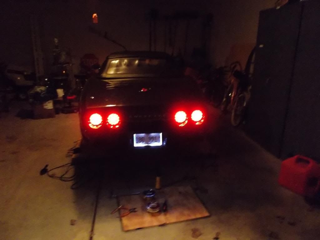

I installed some led tail lights. Wired them so now I have 4 brake lights and 2 signals on each side. Next I will have to add a reverse light.
Looks good. Do you have any issues with the directionals blinking too fast? I read somewhere there is a resistor available specifically to prevent this "hyperflash".I installed some led tail lights. Wired them so now I have 4 brake lights and 2 signals on each side.
Yes I installed a resistor on each side for the signalsLooks good. Do you have any issues with the directionals blinking too fast? I read somewhere there is a resistor available specifically to prevent this "hyperflash".
