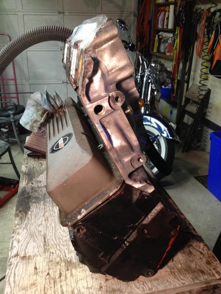

Hello xCrossFirex - I have just gone through what you are looking to do. I have had my car sitting in my garage for years planning my attack and finally got to it. I notice your post is about 6 months ago so don't know if I'm too late to respond but if you haven't started I have learned a ton that may be helpful. Just to let you know I chose to go with porting a set of cheap L98 heads and a Lunati Cam with .490 lift and a ton of duration and don't regret the outcome. The intake will be the limitation as everyone has already posted, but if your just looking for some cheap horsepower and a fun car it's well worth all the work.

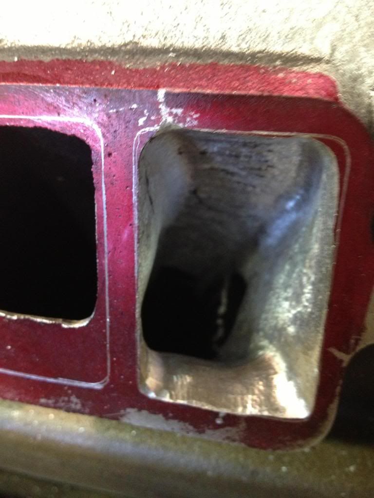

[/URL][/IMG]
This is one of the biggest issues with the L83. The head side opening can be ported to match however the runner size can only be opened up to about 2 thirds of the head end of the runner. But... if your just looking for a healthy street car. it's not so bad. Going to a large cam and higher compression heads will affect the readings to the ECM and will affect timing advance among other things. I would recommend a vacuum advance or mechanical advance distributor. You will have to pull out the idle adjuster plug to have access to mechanical idle settings. Also, you mentioned grinding off the factory TBI balance weld that stops from fooling around with that adjustment; i would grind that off also. All part of tuning. I am using a set of cheap ported L98 heads with a long duration cam and good valve springs running on pump gas with no smog and the car has come to life. I would also recommend a 160* thermostat and a 175* fan switch. 1985 fuel pump. The best thing about this car is that you can do it all on jack stands.
· Registered
62 Posts
Open them up as much as you can. As you can see the middle of the runner will be the air flow obstacle. But even though... with the stock TBI's, it now pulls very hard. Heads and cam (among other things) have brought this thing to life.
