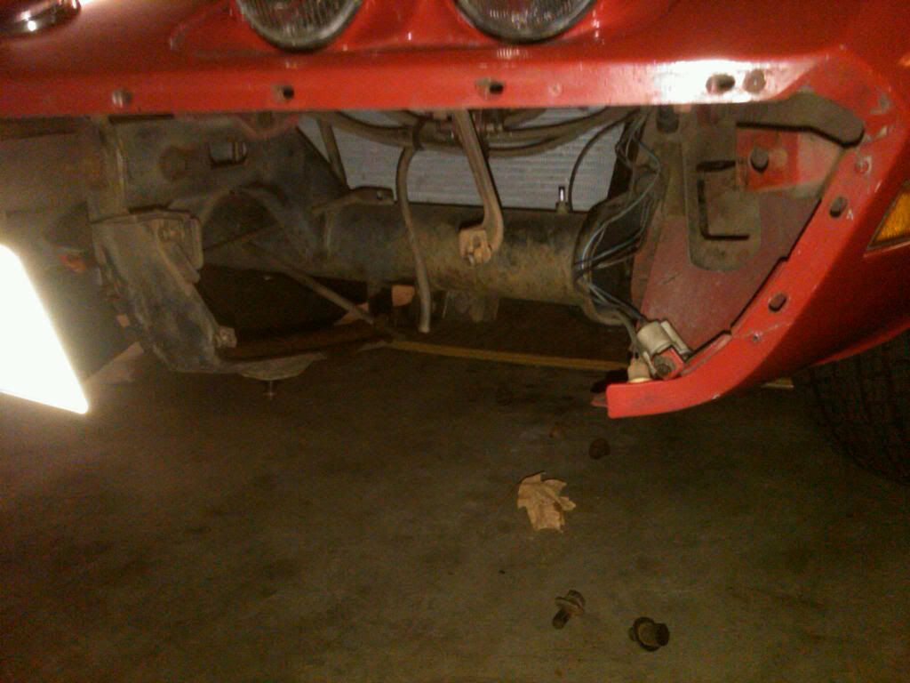

Here are some from today's work...
Here I removed the rocker panels...
Then I removed both front grills and all the supports for the front.
